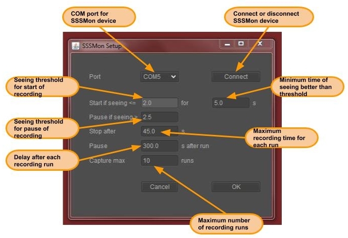

This plugin provides the following functionality inside the FireCapture software:
  • SSSMon measures the current seeing
  • Recording is started if seeing reaches configured minimum quality
  • Recording is paused as long as seeing is worse than configured value
  • Recording is stopped after configured time
  • After recording is stopped and after a configured pause time, a new recording run can be started automatically
  • The maximum number of recording runs is configurable
Screenshot of an example setup:
With this setup, the recording is started as soon as seeing is 2.0 or less (smaller value means better seeing). The recording is stopped after 45 seconds. As long as the seeing is worse than 2.5, the recording is paused. After a recording finished, there is a (minimum) delay of 5 minutes (300 seconds) until the next recording might start (if the seeing is better than 2.5 again). A maximum of 10 recoding runs is executed.
Start this setup, have some cold beverage and let the plugin hunt the moments of good seeing.
