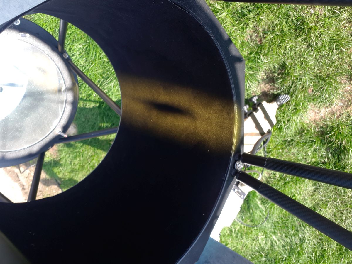

The amount of solar power collected by the mirror is estimated to 90w. As much as a quite powerful light bulb.
The scope is of newton type, thus a big part of the heat is concentrated on a circle of about 50mm in diameter at the location of the secondary mirror, then further concentrated to the focus and forth.

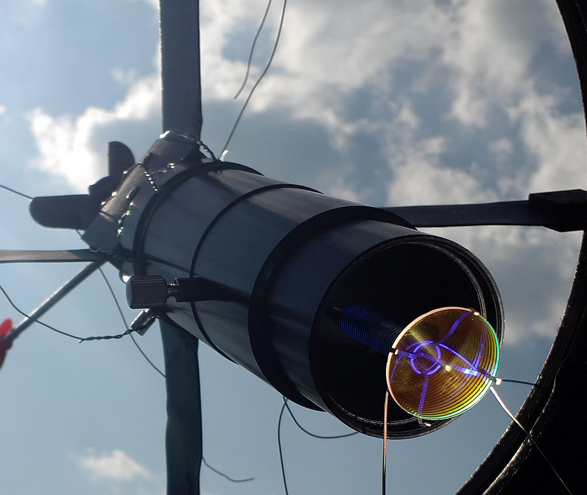

Here the ERF would be as big as the secondary, thus about 50mm in diameter, located in front of the secondary.

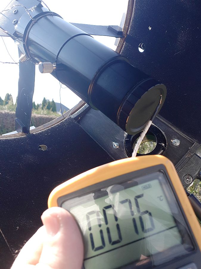

I started with various trials, measuring temperatures, etc.

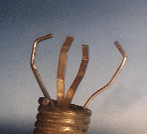

You can figure what will come into these fingers...
... A blue interference filter suffering the full flux
The filter resists.
I tried also to partly target the filter, so to have one side "cold" and the other side "hot".
The filter still resists.

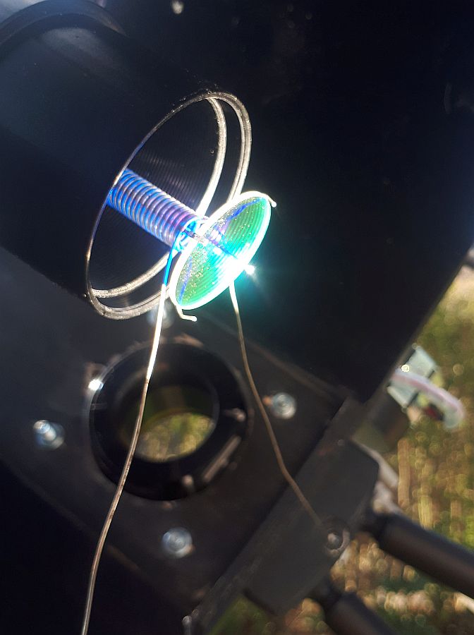

This is one of the indirect danger of the application. In this picture the flux is reflected back toward the body of the telescope, leading to a local heating. I experienced also a returning flux against the carbon truss; they started then to generate smoke.

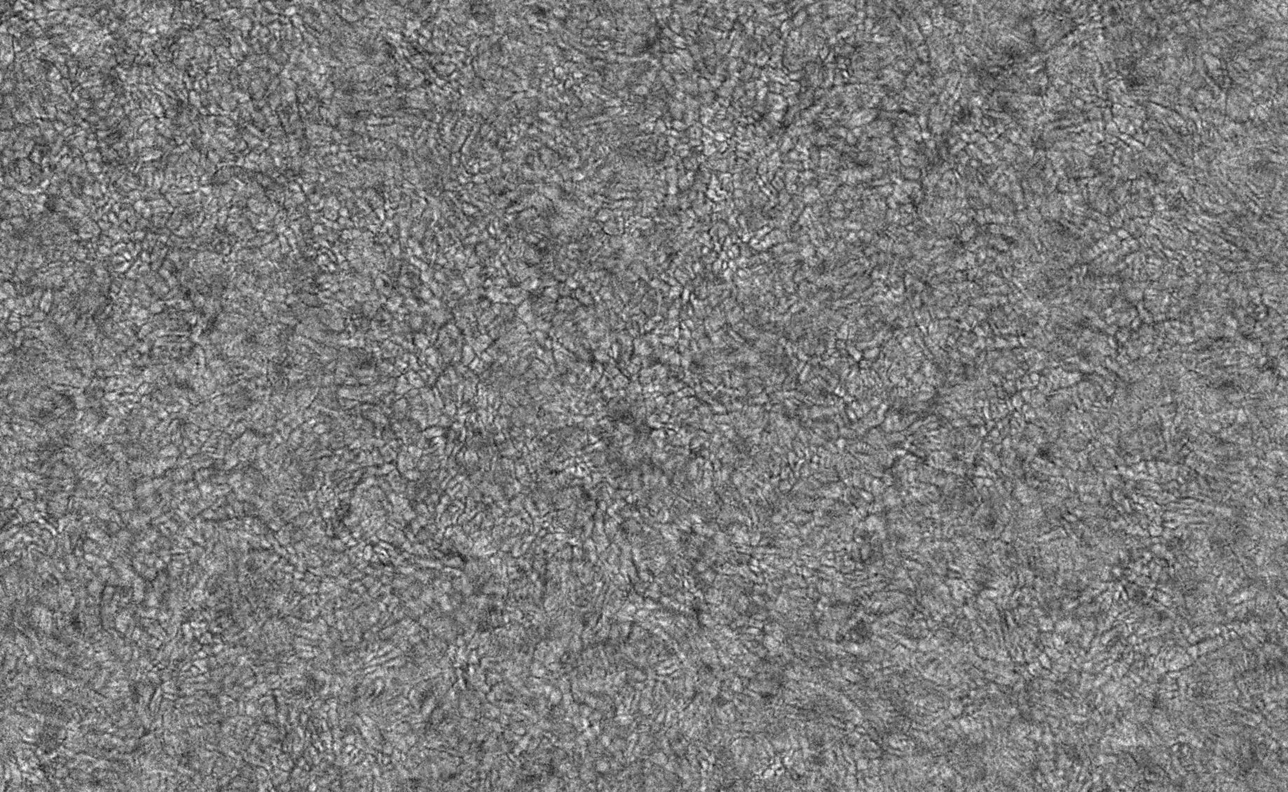

In my area, a small city suburb, surrounded by streets and houses, I could get some granulation.
Looks "interesting" at this stage. Here in blue.

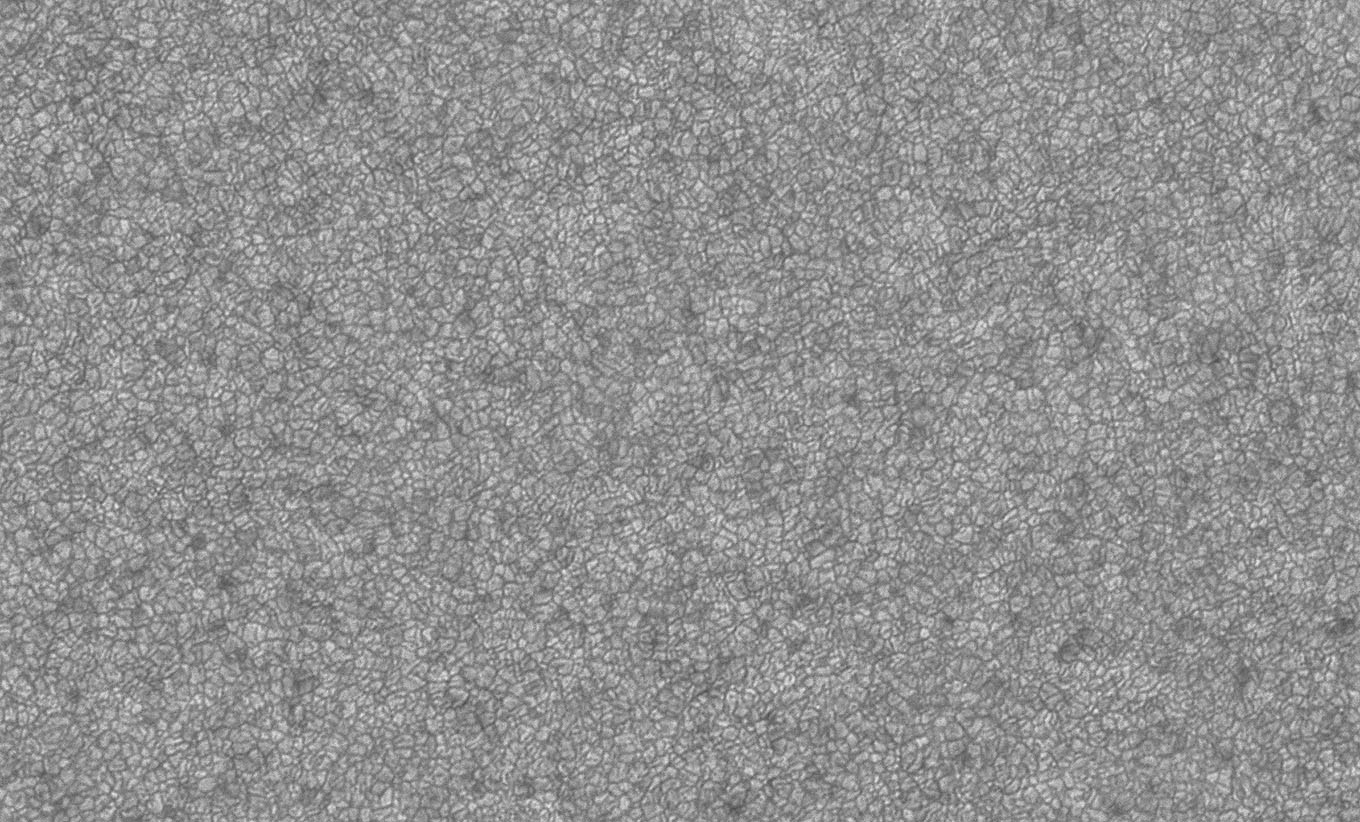

So, I went out of the city for further trials.
I could get better granulation pictures, in the red domain. In the blue, the pictures were awful.

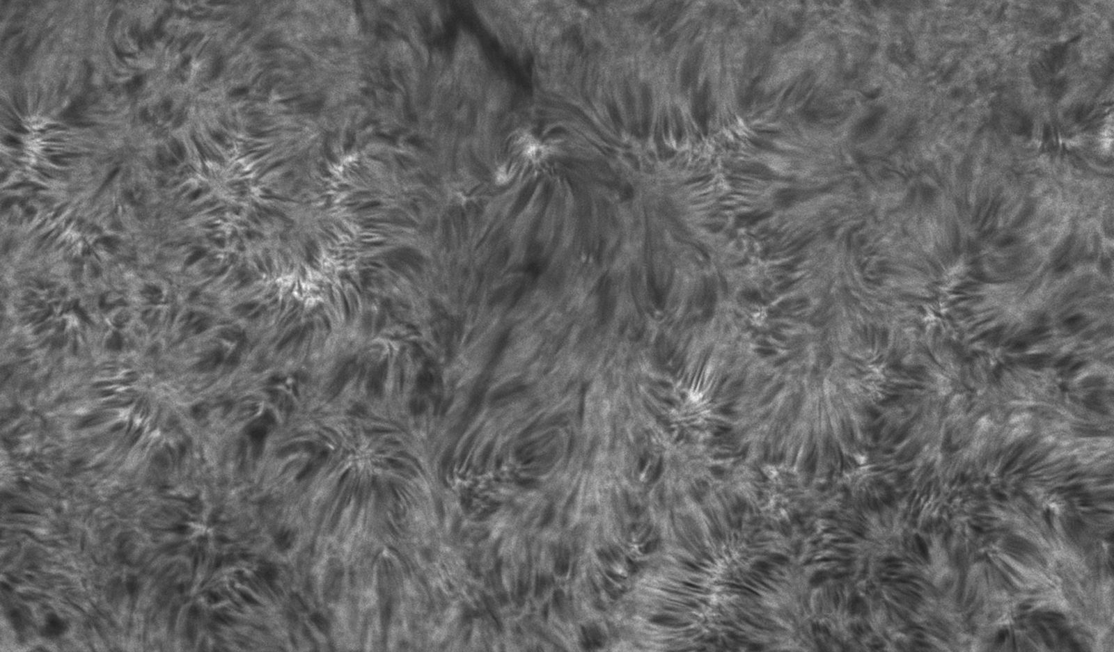

The next step was a trial in Ha.

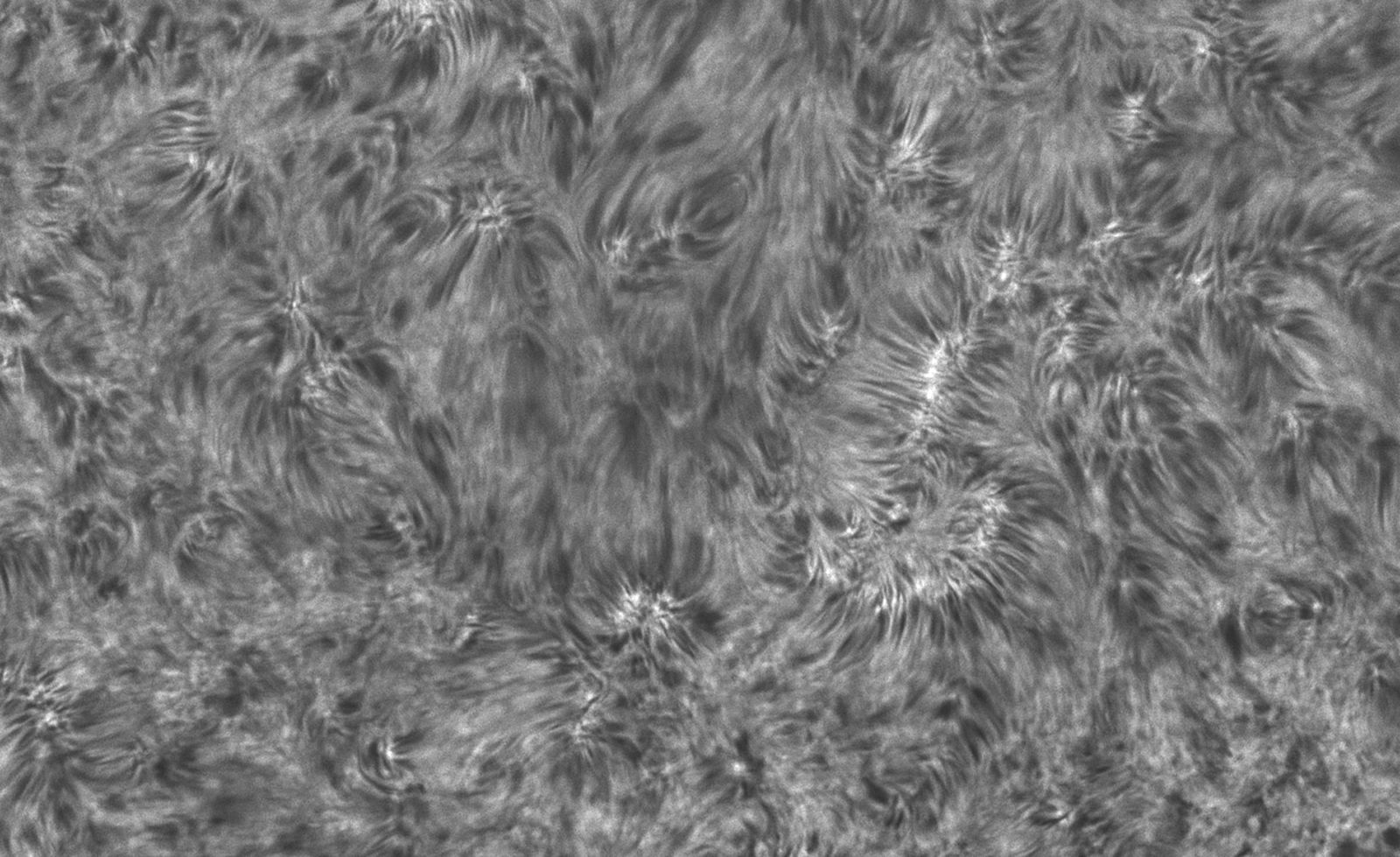

Here also, I could get some results, but not easily. Only when the seeing was stable. And only with a focal reducer.

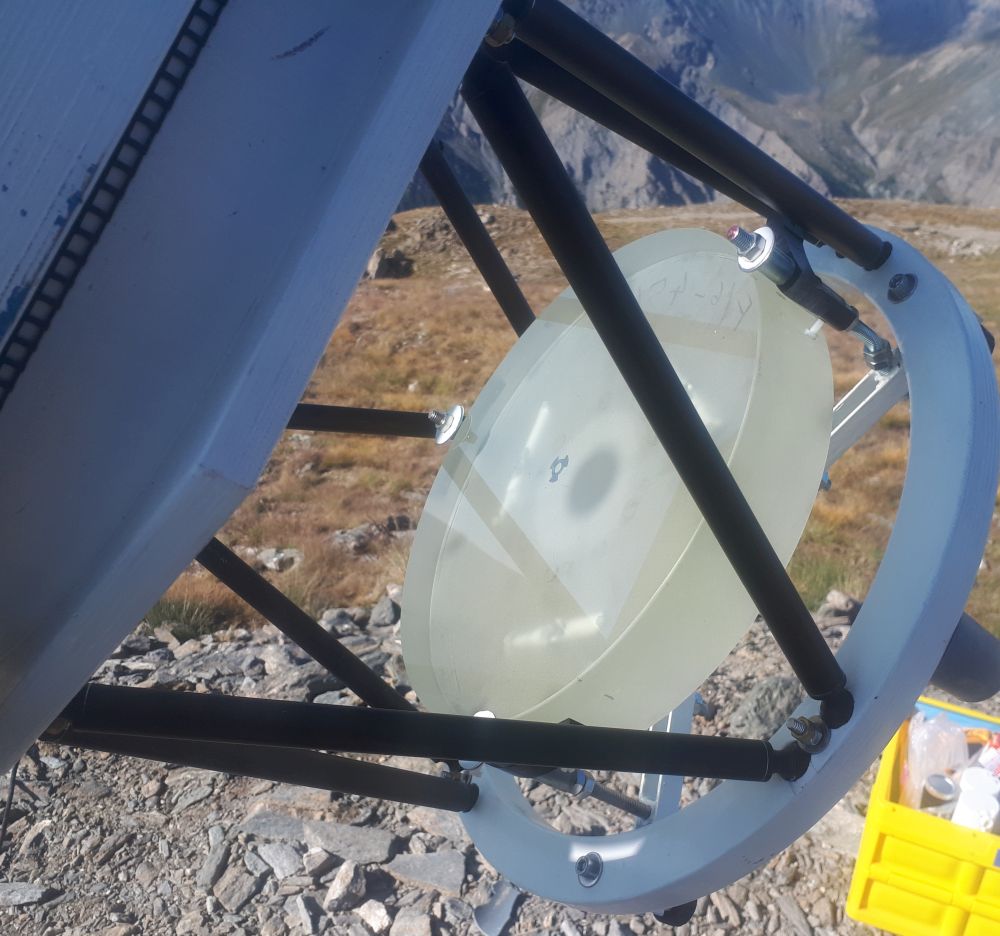

So, I went for removing the primary mirror coating.
Here, the first pics in bad seeing and bad wind conditions, in KLine with no coating on the primary.
I had later a chance to observe with the de-coated mirror in better seeing conditions. Here under 450nm
The conclusion is clear.
